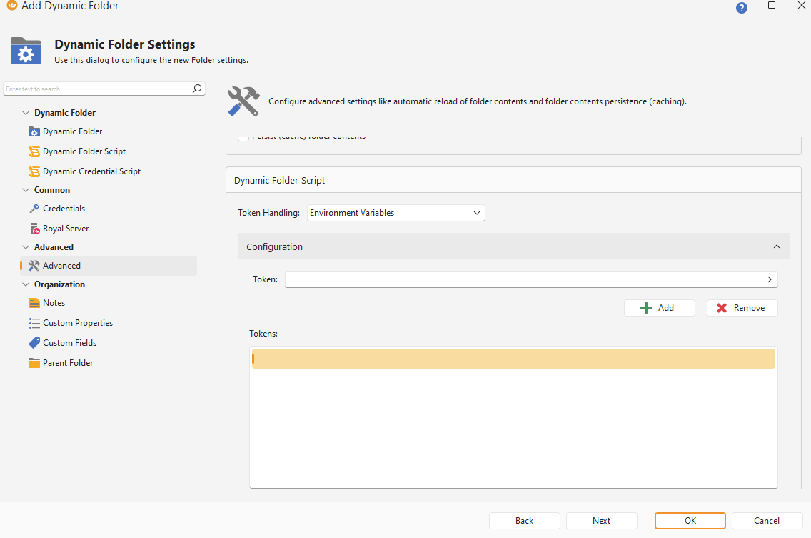

7.3 beta is available here:
https://www.royalapps.com/go/kb-ts-win-downloadbeta
On the Advanced page in your Dynamic Folder configuration you can now use environment variables as an alternative in your dynamic folder and credential scripts.
Would be great if you can test that feature and provide feedback.

I've tested the new beta version 7.03.11022 and everything seems fine. Thanks
  • I found another bug in beta 7.3.11022: if you enter nothing in the text box next to “Token” but press “Add”, a blank line is added to the list of “Tokens”.
  • How are JSON environment variables implemented?
  • The documentation should provide an example specific to the selected language. For example, in PowerShell give the example “$env:DynFolder_EffectiveUsername” and do the same for other languages. Or at the very least, add a link to a more detailed documentation web page.
Damien

thanks for the feedback once again. I've fixed the issue where empty tokens can be added to the list.
